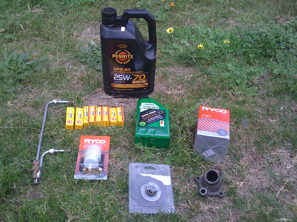

Well today, i got some more bits and pieces for Red. These were...
New 70 degree thermostat,
Thermostat housing and gasket,
Coolant,
New sparkies,
5L Penrite oil (Only the best, cram that other shit up your ass. Penrite all the way!)
New oil filter
New air cleaner filter (Not pictured)
New inline fuel filter
My old double pumper fuel rail off my methanol 327 chev. (Looking very lonely in the horse shed)
Today i got the fuel rail on with the fuel lines plumbed up, the thermosat on, sparkies in, the new leads on and wired it up for a quick start to see if it ran. I aslo started to put the alternator on by combing two togther to make one, but i ran into problems, so i decided to put it into the to hard basket for the moment. I will sort that later.

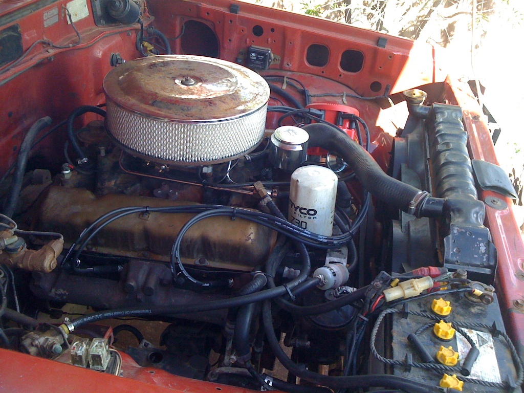

First off it didnt quite wanted to start. It wanted to, but it just wasn't enough to start, i retarded the dizzy and vroom, she sat the idling loud as fuck with no exhaust on. I took the muffler off ready for it to be replaced. Of coarse i couldnt help myself, i had to give it a few good revs to wake the neighbors up and say ITS ALIVE!!!!!
Air cleaner also went on today but its not shown in the picture below.
Tomorrow's job is to get the radiator done with the replacement thermo fans attached, plus get the sump changed over. I also intend on putting a oil cooler to the engine just to cut a couple of degrees down on the engine. Every little bit helps to keep this beast cool.

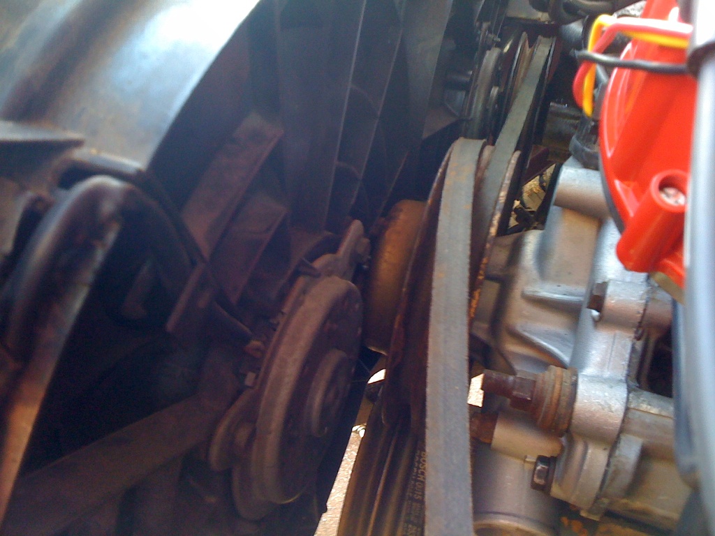

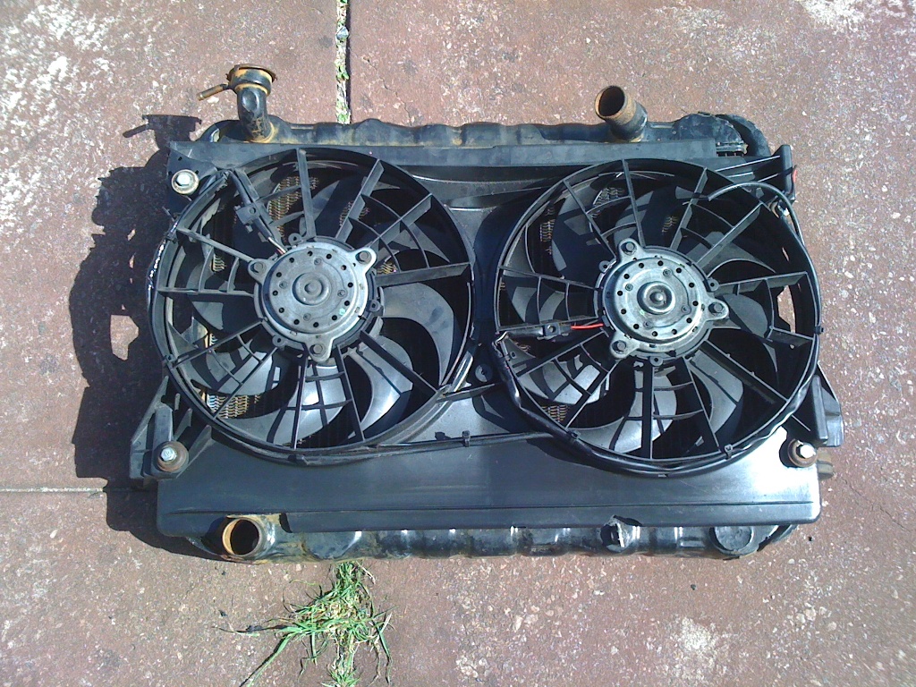

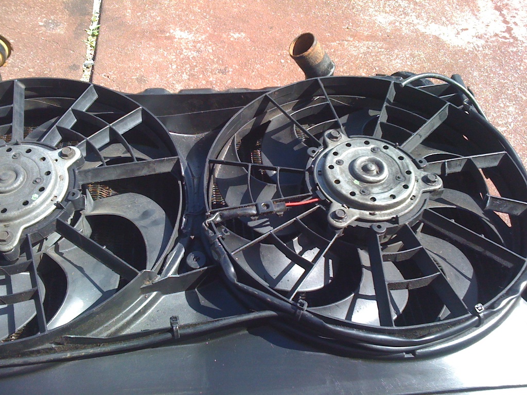

More work was done on Red today. Radiators in with its replacement thermo fans attached. Took a bit modify to get it to fit in there but with a bit of angle grinding and few holes drilled, it was done. A very tight squeeze, i can tell you that. If i ever fuck a fan belt, the radiators got to come out to replace it coz there is absolutely no room between the pulley and the thermo fans to get it out. I had to cut bits out of the thermo fans to get the pulleys to clear.
The radiator, ready to go in.
Note the pieces cut out to clear the pulleys.
No much clearance now

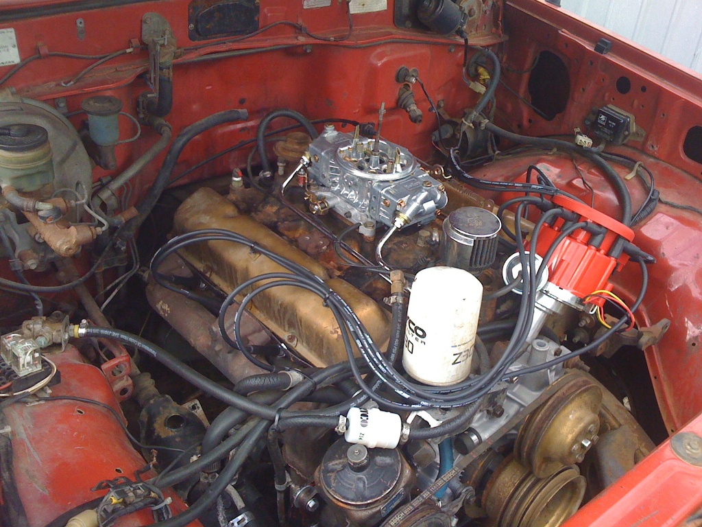

The next thing is to do the sump, find a replacement solution for an alternator and do the exhaust. The way things are going, it will be hitting the dyno on dyno day.
Pic of how it is now.
