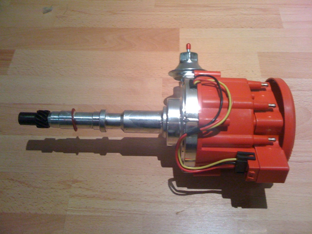

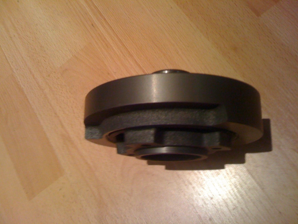

My big "fuck off" dizzy has arrived with my new harmonic balancer. Im also waiting for water pump and other odds and sods to arrive.
Cant wait to get the beast going again. The pig wouldn't start the other day for some reason. I think the carby is totally stuffed. I hate vacuum secondary carbys. Prefer manual any day. After a few times off trying to get it started the other day, i said fuck it and shut the bonnet. I will get back into it when all the parts arrive.

Oooh!! Looks like you mean business there! Lol. Shame about not starting, I'm not a huge fan of carbies personally. They cause more issues then they're worth for me, but they definitely work.
